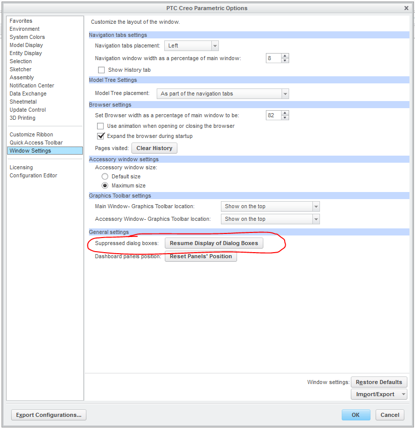

How do I bring back the config.pro-Save-window? I clicked the "Don't show this window again." box, and now want it back.
When you make a change to your config.pro file, it defaultingly asks you if you want to save the change when you hit OK.  There was a box on the bottom that read, "Do not show this window again."  And I clicked it.  I now want that window back.  Where is the place to turn this back on??
help please?

Jul 6, 2016 5:14 PM UTC
File, Options, Window Settings
Jul 6, 2016 6:16 PM UTC
oh thank you!
I didn't know that's what I was looking for . . .
t'anks bunches.
