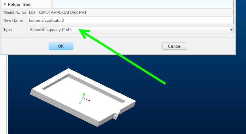

Since you are on a student edition, I cannot open the files, but once you are in your file. Do a File, Save As and then below where you type the name, select the .stl extension as the type of file you want to save. Then type in the name you want to save it as if it is different from the default. That should work.

There might be an issue of the part is not solid. If it is a surface model, the STL save-as option is not available.

Yes, STL will be available for solid models only.
