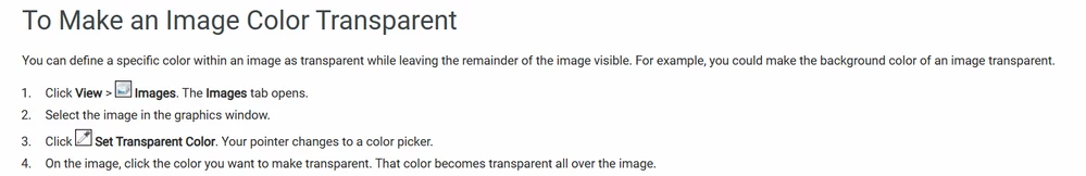

Assuming you are using the images functionality to place the image in your drawing. Follow these steps.
November 27, 2023

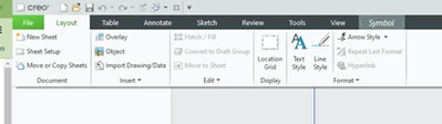

Hello and thanks for replying!
I do not seem to have the images option under View. So far I have been inserting images into Creo's format files using the Layout > Object pathway. Do you have any ideas as to how I can get this images option in the View tab? Thanks so much for your help!
I believe I have attached two images so you can see my Creo Toolbar options
Image 1
Image 2
