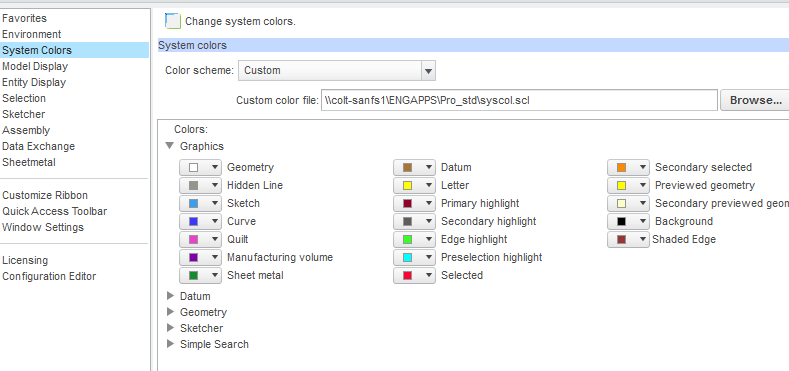

File > Options > System Colors > 'Shaded Edge' at the bottom of the right hand column.

I do have the Shaded Edge as a reasonable color but when you go into the Wireframe display style it is evident that the edges for all solid geometry are white.
