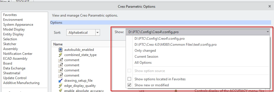

January 25, 2019
I'm trying to coach a new user in CP4 configuration settings and the CP4 configuration editor has me befuddled.  Where Creo reads configuration files has been asked an answered.  Creating a new configuration file is fuzzy.
In our installation, load point and start-in locations are controlled by the sysadmin.  So the next logical place for personal options is %HOMEDRIVE%%HOMEPATH%\config.pro.
Since he's a new user, he doesn't have any configuration files here.  I can brute-force it the pre-Wildfire way with Notepad, but I have a hard time believing that's the CP4 "recommended" way.
Example: He doesn't read his message area. To solve a pain point for me, I want him to have 3-5 lines show up in the message area.
Expected outcome: From the Configuration Editor, create new config.pro file in the %HOMEDRIVE%%HOMEPATH% folder, containing the visible_message_lines and the desired value.
Undesirable outcome: duplicating any option from "all options", "current session" loadpoint, start-in, etc. into the %HOMEDRIVE%%HOMEPATH%\config.pro.  Why? If the sysadmins change an option in the loadpoint or start-in locations, the leftover garbage in the personal config.pro.  (Let's not bring up a config.sup discussion - not helpful for this question.)
Undesirable outcome: Saving the property in the loadpoint or start-in config.pro.  Why? Overwritten by sysadmins.
January 30, 2019
I see nothing wrong with this approach, as long as you know correct option names and their values. Config.pro is a text file, it doesn't matter what method you used to create it.
In Creo options are exported with regard to filter set in upper right corner, as you can see here:
If you want to export only newly added options and not all the options read to current session, simply change this Show filter to Only changed and then export configuration to config.pro. It should contain only the options you added (or modified) in current session, not all the options loaded into session.
