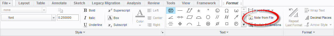

how in Creo 3 do I in drawings insert a note from file. I have search path set in config but command does not let me go to files with notes in it.

  • place new note on a drawing
  • Creo displays Format tab
  • click Note from File button located in Format tab

Just to follow up on Martin's suggestion, here is a snapshot of the Format tab:

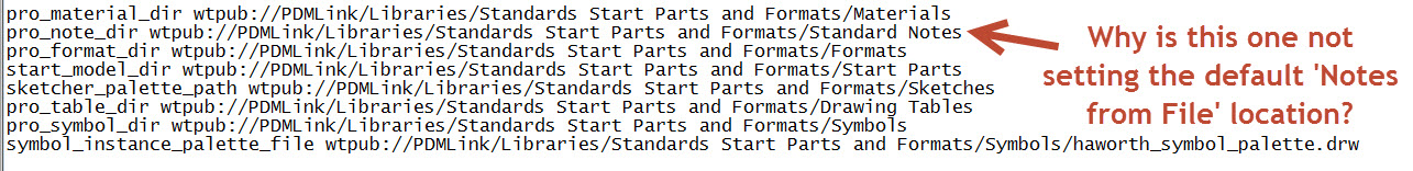

I'm having the same issue with built Creo 3 M060. The file path is set in the config option but the location does not comes up when clicking on the 'Notes from File'. I'm using the pro_note_dir and the other similar items see to work. The other directories are working me but that one is not. Maybe it's a typo but I'm not seeing it...

It looks like it's a product idea to have it point there. Up vote it!
When pro_note_dir is set "Note from file" should start there.

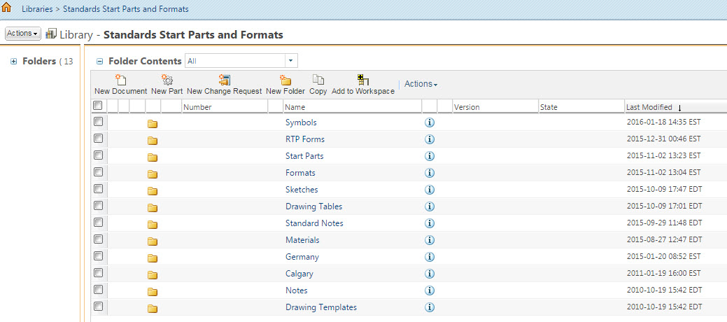

Also, for my example above...  there is a Note folder and a Standard Notes folder in my Windchill. Calling the 'Standard Notes' folder is appropriate.

Lucas Hoogeveen has given you link to When pro_note_dir is set "Note from file" should start there. This idea contains detailed explanation of pro_note_dir implementation. The same information is available on https://support.ptc.com/appserver/cs/view/solution.jsp?n=CS74249
  • In order to access the location of pro_note_dir after making the menu selections to create a note from file and the Open dialog box appears it will go to the working directory.
  • To access the note directory access the list box titled Look In and there will be a special entry there called Note Text Directory that will use the location specified by pro_note_dir.
