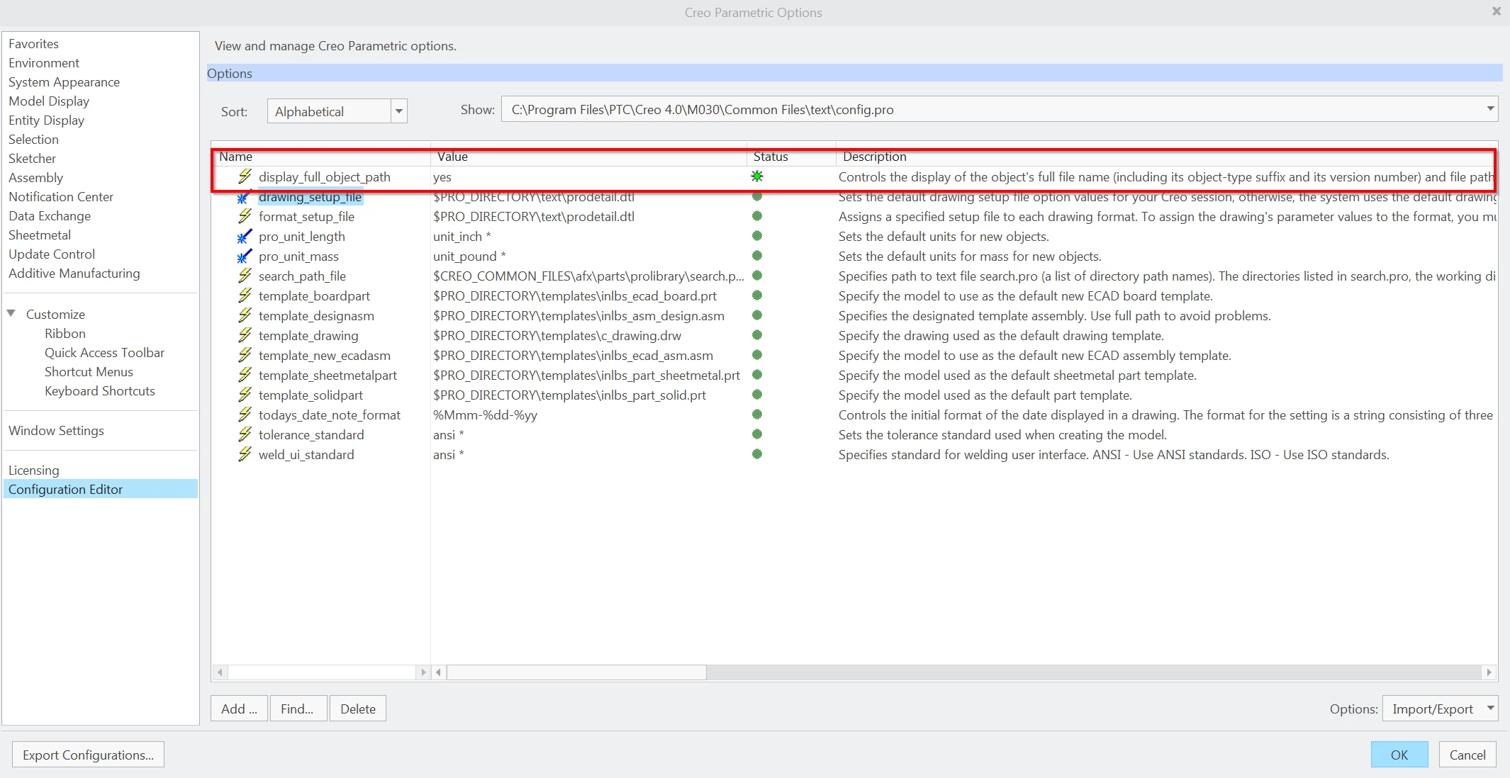

That is correct. In Creo 4.0 I went:
FILE >> OPTIONS >> Configuration Editor
There I added your command name and Value. Or in Show menu you can select All Options and it will show all of the available configurations names.
Then by right clicking on the part in the model tree and selecting Information >> Model Information, the PATH can be seen against the file NAME.
Screenshot attached for reference.
