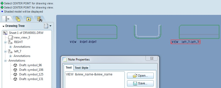

We change our view projections and toggle from 1rd angle projection (Europe) to 3rd angle projection (US).
To avoid mistakes, (of course symbol in Title block is changed) we want to add the name of the projected view under each drawing view.
The config option: make_proj_view_notes = YES , do it automatically.
But: the view name is the default name, and the system write the view name twice as shown in picture.
It seems not possible to define the option to write a view name only one time, but always twice "view_name-view_name"
Users need to manually correct it.
Did someone use that option "make_proj_view_notes = YES" and how do you manage that please?
Thanks.

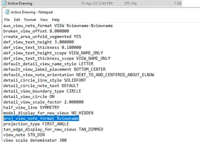

@KulbirSandhu you can change "projection view note format" manually by saving .dtl file and edit using note pad. Default setting have name format as "Default". If we can find the default format setting, i think this can be edited as required.
