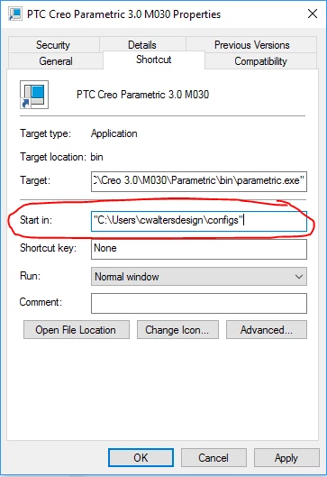

May 8, 2018 7:16 PM UTC
Edit the PTC Creo Parametric desktop shortcut:
- right click the shortcut icon
- select "properties"
- select the "Shortcut" tab
- change the "Start in:" location to wherever you want to locate your config file (see image)
