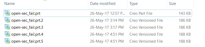

How to control creo versoined file with in a single?
I forget the config.pro name or category to change this.
Kindly find the attached image for details.
thanks

See this discussion:  Re: Is it possible to turn off Creo's versioning feature?
It is NOT a good idea to turn off the iterations! This is your only backup. If you turn off the iterations and you have any kind of corruption, you will have no recovery options.
May 31, 2017 8:50 AM UTC
If you are using a third-party versioning system such as GVFS, use save_file_iterations false to disable the built-in versioning system.
