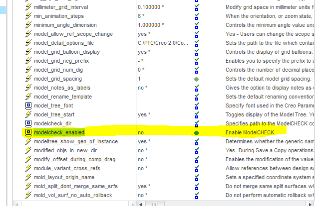

I am facing problem in Creo 2.0 M150 built code. While saving big assemblies or every cad documents, Creo run model check every time.
I tried to make ModelCHECK enable set to "NO" but still it is checking model chek.
Can anybody help me on this so that I can work on very big assemblies.

You may want to check to see if:
  - you have a config.sup that has this enabled
Jun 2, 2015 12:49 PM UTC
Probably this (config.sup).
The ModelCHECK .MCH file also has settings in it that will run it on every save. I'm not a big fan of that. Talk to your admin and ask why that is. Probably a small number of users weren't running it and this is the (over-) reaction. Explain the time-sink this involves and ask for it to be turned off.
