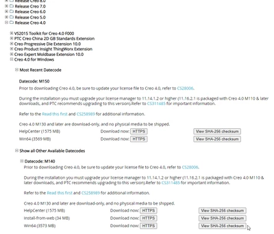

The oldest datecode available for Creo 4.0 is M140:
Do you have a particular requirement to have the M060 CD?

Yes, our customers are still using M060, so we have to set up the environment and verify our solution on it.

Right you need to verify your customers files and make sure that he supports yours in turn.
Like @BenLoosli pointed out, the compatibility within a release is guaranteed by PTC so when you open your customer's file with M150 and save it he will be able to resume with M060.
If the contrary happens, then it is against our warrantee and we will do everything to have that resolved.
On the other hand compatibility between releases is guaranteed solely backwards meaning that Creo 5.0 will open Creo 4.0 files for example.
