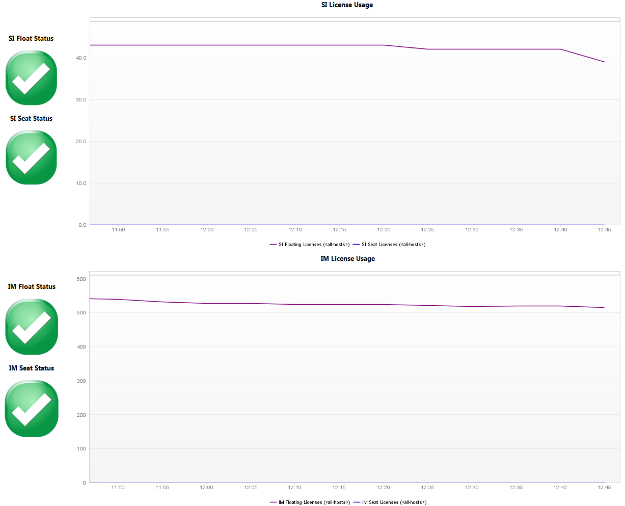

If you want to monitor and track license usage over time, I suggest using the PTC System Monitor (PSM) to do this. An example screenshot is shown below:
