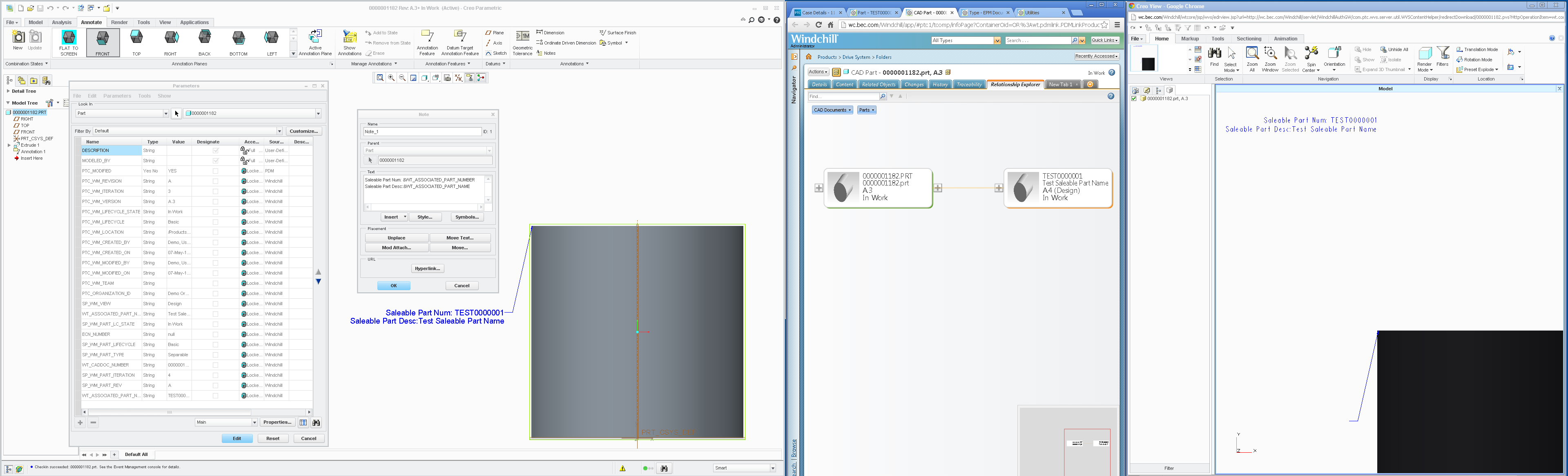

I can see some extra parameters in the same list which may meet my needs: PTC_WM_PART_NAME, PTC_WM_PART_NUMBER (Description : Identifies the name of the property in the CAD tool that shows the CAD Document's "Owner" associated Part Number. The value may be set to a CAD System Attribute. The default value is PTC_WM_PART_NUMBER.)
The problem is that I can not find these parameters (PTC_WM_PART_NAME, PTC_WM_PART_NUMBER) in Creo model. If I try to add parameter with any of these names to Creo model I have the message that this names are reserved.
Is this bug? Or am I doing something wrong?

To close this community thread on How to get Windchill Part Name and Part Number in Creo Model
Summary of the exchanges and list of solutions:
  • The functionality was not present Out of the Box in older releases of Creo and Windchill as confirmed by the article CS18803
  • Those parameters were added with Creo 6.0 associated to Windchill 11.1 M020 as highlighted in article CS347570
  • You may then receive messages on the inability to propagate the parameters for legacy models, see article CS314319
  • In previous versions you could develop a Customization of the Windchill Download Service to do so, a sample is available in the article CS287504
  • Refer to article CS24526 for more information regarding these system parameters

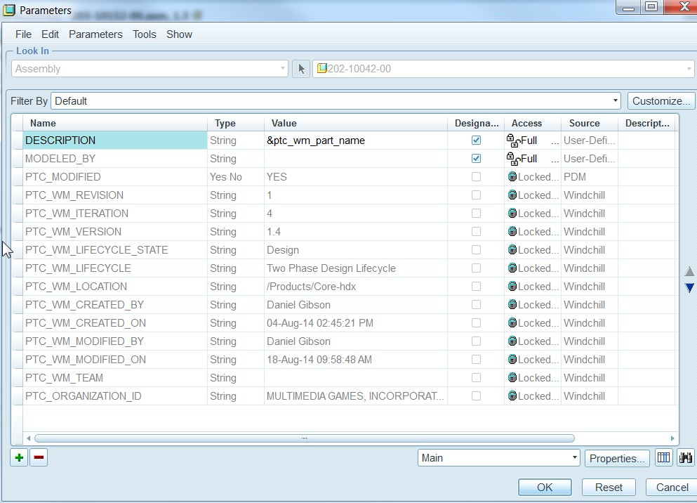

We have not changed any of the OOTB preferences for attribute mapping yet in our v10.0 M020 test server, and we assume this is the reason that we only see 9 of the 17 Attributes listed above being added to our Pro/E Wildfire4 files immediately upon Save to Workspace, even though WTParts are being created and associated automatically with the CAD Docs. A similar (but not identical) list of 9 default attributes is shown on the old TAN 118262 https://www.ptc.com/appserver/cs/view/solution.jsp?n=118262. Wouldn't it be nice if PTC kept all TPIs/TANs up to date ?
In addition we see the following 4 extra Windchill system attributes (Parameters) being added automatically in our Pro/E files :
PTC_MODIFIED (listed as Yes/No but drawings display it as True/False)
PTC_WM_LOCATION (the path to Windchill context and folder)
PTC_WM_TEAM
PTC_WM_VERSION (= PTC_WM_REVISION. PTC_WM_ITERATION)
In our test setup we still make use of the “old” PROI_VERSION parameter to display on drawings instead of PTC_WM_ITERATION, as it very usefully shows the +sign (like you see in the Windows title bar) as soon as the file is modified in session (and we have also set the config.pro option dm_emulate_ilink_sys_paramters = yes). The +sign is also shown correctly in the WGM, but for some reason PTC have stopped appending it to PTC_WM_ITERATION and instead suggest we make use of PTC_MODIFIED to indicate if a file has been modified locally and not yet checked-in. Unfortunately this change will require some customisation work to re-instate the original behaviour on our Pro/E drawings if the PROI parameters are ever dropped by PTC in future (eg. to translate the True/False values into “+” / <blank>).

Hi Jonathan,
What's the simplest way to add PTC_WM_NAME and PTC_WM_PART_NAME to parameters?
We currently reference the revision (&PTC_WM_REVISION) in our drawings and it would be nice if we could reference the Windchill "Part Name" and Windchill "Name" as well.
I've tried looking through the Windchill Customization Guide but I it's a little over my head. It seems odd to omit those two fields from the default parameters. I wonder what the impetus for that was.
