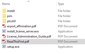

Once you've downloaded the software, which is in a ZIP file format, the installation software programs are included in there. A typical listing (this one is for Creo 9.0.9.0) looks like this:
Creo Zip File ContentsCreo Zip File Contents
To install the license server you need to run "install_license_server.exe". Do this first.
Once your license server is running, use the "setup.exe" program to install Creo.
