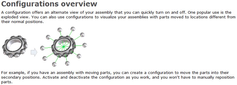

have a look at Structure -> Configurations.
With this tool you can save visibility and also the positions of parts and assembly's in a comfortable way.

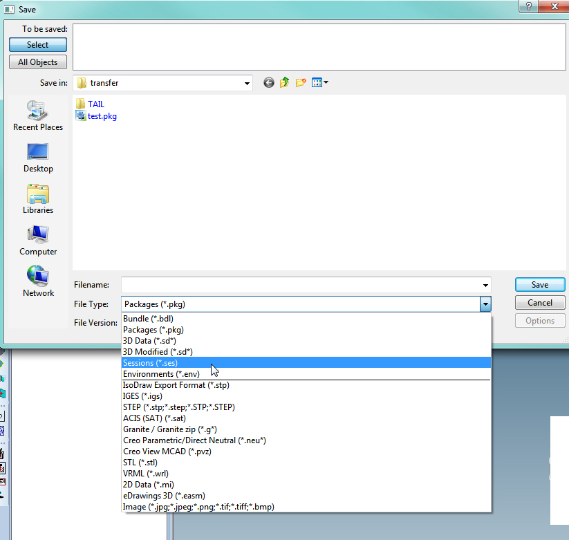

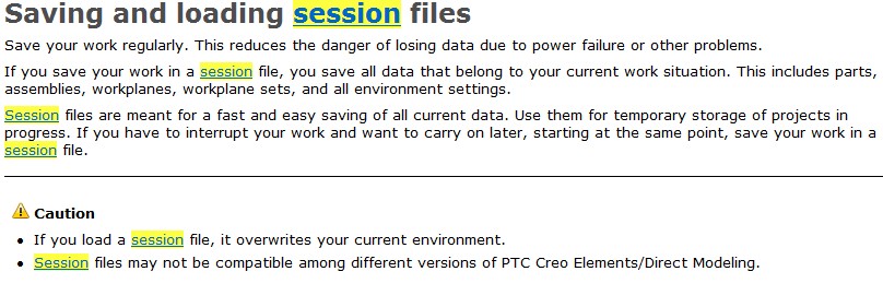

One other possibility is to save as "Session" .ses but this is not a long term solution by cause this saves also the whole environement.
If you or a collegue load such a file later in time the actual environnement will be overwritten and is lost if you have no backup.

Hi FriedhelmK: Thanks for that information and the video to boot! That's a much more elegant and scalable solution than using containers.

Another option is to save a session. This saves the current open session including all settings, what part is active, what parts are shown and hidden.
