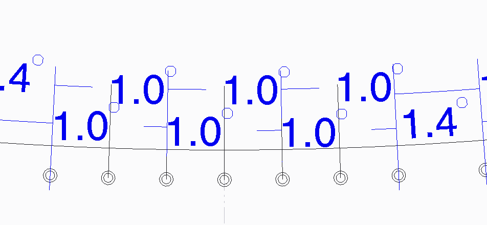

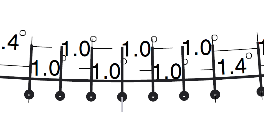

I am using a Net Based Creo Parametric 2.0. When I export an engineering drawing to a PDF file, the resulting lines are too thick, and obscure some of the fine details. I have attempted to follow what others have written, which have to do with including pentable files in the working directory and/or modifying the config.pro file, and checking the "Use Pentable" box in the export dialog box. However, (1) there is no pentable.pnt file in my working directory, and when I create one (opening a notepad text file, copying some suggested block of code like the one below into it:

If someone would be so kind, what I seek is a clear, step-by-step explanation of everything I need to do to get a PDF with thin black lines from a drawing, including any blocks of code if necessary, the proper way to create any files, what folders to put them in, etc.

Put the attached file in your working folder. (table.pnt)
Use the Save-As Export PDF and set the "use pen table" option manually
Check the Stroke All Fonts... just to cover all basis
See if this -at least- will give you something in the direction you are looking for.
After that, we can look at tweaking it.
