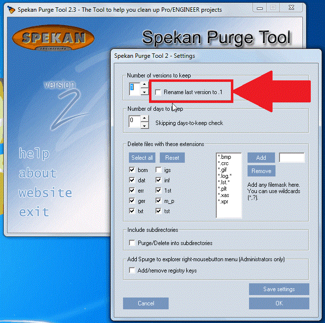

    Instead of this l´m using Spurge utility. See folowing topic Re: Spekan Purge Tool
    There is possibility to rename last version to no:1.
    But the number of version will be always included in file name.

    Thanks for the help, do you know with if there is way to rename last version to no. 1, without using the Spekan purge tool?
