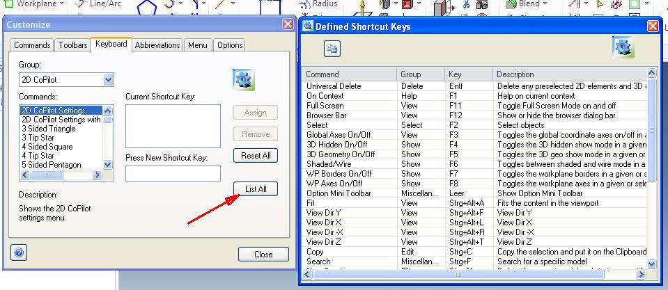

I'm starting to customize my interface and coomands, with the settings (file>settings>background, system, etc...) i din't have any problem, i made my changes and when i close and re open creo the settings are the same. Instead, with the customizations (file>customize...>keyboard shortcuts, etc...) when i make some changes and close creo the next time i open it the customizations are all restored to default and i can't find a way to save my custom keyboard shortcuts and others. How can i save these customized options?

you are in this forum:
Creo > Creo Elements/Direct and not in Creo parametric
Mattia do you ask for Direct Modeling (Version?) or Direct Modeling Express 6.0 ?
There are a lot of predefined shorcuts.
Dit you use some of them?
