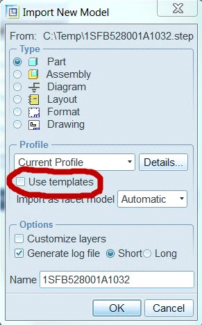

How to set check box "Use templates" automatically using config.pro?
How do I set check box "Use templates" automatically using config.pro, see attached picture?
I want this check box to be automatically chosen when importing new models.

Found in Pro/E Help center :
" You must set the value of the intf_in_use_template_models configuration option to yes to use start part and assembly template files when importing parts and assemblies through File ▶ Open "

Hi Zacharias,
I didn't dig very far and I am not sure off-hand. If one doesn't exist, you could try creating a mapkey.

Good find, Sylvain.
Zacharias, here is another document on this. You may want to set options "template_designasm" and "template_solidpart."
