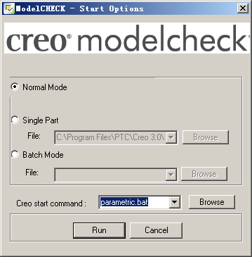

Hi.
Click run without any response
I have a large number of parts or components that need to modify the parameters, I will operate in interactive mode, but I do not know how to operate in batch mode. Can someone help me? Thank you ~!

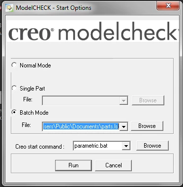

December 8, 2017
1. short cut for modelcheck.bat
2. Modify the Start in folder to where parts are located
3. In the Start in folder, a config.pro has MODELCHECK_ENABLED set to YES
4. Run modelcheck.bat, select the .lst file (created in cmd) and parametric.bat
