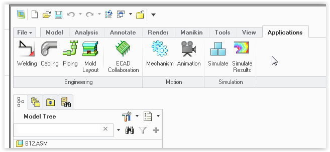

I'm new administrator and we just buy a new licence : Advanced Framework (floating modules). Also, we are new user with Creo Parametric 2.0. I need to know how to validate this licence, how to use it.
I activated it but I don't see anything change in the menu.
Did somebody can explain me what this licence is suppose to do?

I can't remember but is this one of the application menu items, like piping. Once you add it to the session, you have to go to application tab and select advanced framework to get the menus for it.
Also, I think you use it in an assembly, so if you are in a part, it won't be an option.
I never used advanced framework but I saw it in a demo some time back. I just don't remember any specifics.

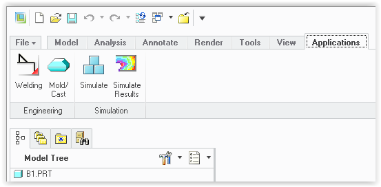

Thank Stephen,
But I try to look in application tab, I didn't see anything. I try it for both parts and assembly.

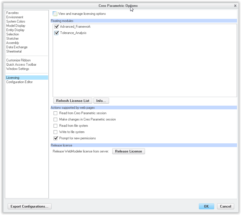

Set config option afx_enabled as yes, relaunch Creo.
In assembly mode, you will get a tab for Framework

did you buy AFX from PTC or from B&W software GmbH ?
I guess that you bought it from PTC.
In this case you have to know that AFX is not a floating option, it is an extension.
Check your license file, if it contains a block similar to the following one:
#################### Extension ###########################
# Serviceable = Advanced Framework Extension
# Feature Name = 213
# Feature Version = 33.0
# Number of Copies = 1
# Expiration Date = permanent
# Module = Advanced Framework
INCREMENT 213 ptc_d 33.0 permanent 1 AAAAAAAAAAAAAAAAAAAA \
VENDOR_STRING="VSVER=2.0 STARTUP LO=()" SUPERSEDE \
ISSUER=PTC-WEB-LPR ISSUED=06-feb-2014 \
NOTICE="customer identification" \
SIGN2="AAAA AAAA AAAA AAAA AAAA AAAA AAAA AAAA AAAA \
AAAA AAAA AAAA AAAA AAAA AAAA AAAA AAAA AAAA AAAA \
AAAA"
If you want to use this extension, then you have to attach its code to a Creo license inside psf file.
Go to CREO2_loadpoint\Creo 2.0\Parametric\bin directory and open your psf file (default file name is parametric.psf).
Inside this file go to the following line and add 213 code into it.
ENV=CREOPMA_FEATURE_NAME=PROE_FoundationAdv (213)
If you need additional information, please let know.
BTW, you have to fulfil two other conditions:
  • during installation you do not have to uncheck AFX module (after you click Customize button)
  • you config.pro file must contain AFX_ENABLED yes
Good luck

Welcome to the wonderful world of PTC confusion:
you can float an EFX licence but it needs to be checked out by the user when they start creo. you need to create comand configurations to do this.
So fire up your installation or run the reconfigure, go to the applications screen in the installation assistant on that page there is the customize button, click it.
under the application custom settings go to the command configuration tab, this is where you create your startup configurations,
Note: to my knowledge you have to do this on ever machine individually... small number of users here so it has not been an issue for us.
Click add, give your configuration a name and give it a discription, its the discription you will see on creo start up, then what you do is move the licences you want from the avalible column to the startup extentions and floating options just hit the over arrow. once you have your configurations setup you finish your installation.
then fire up creo you should get a box that pops up on start that says what configuration do you want to run, select the one with EFX in it and then you go to the applications tab and click frame work and your in.
I hope that is somewhat clear.... you do the same thing for any of the "floating" modules
