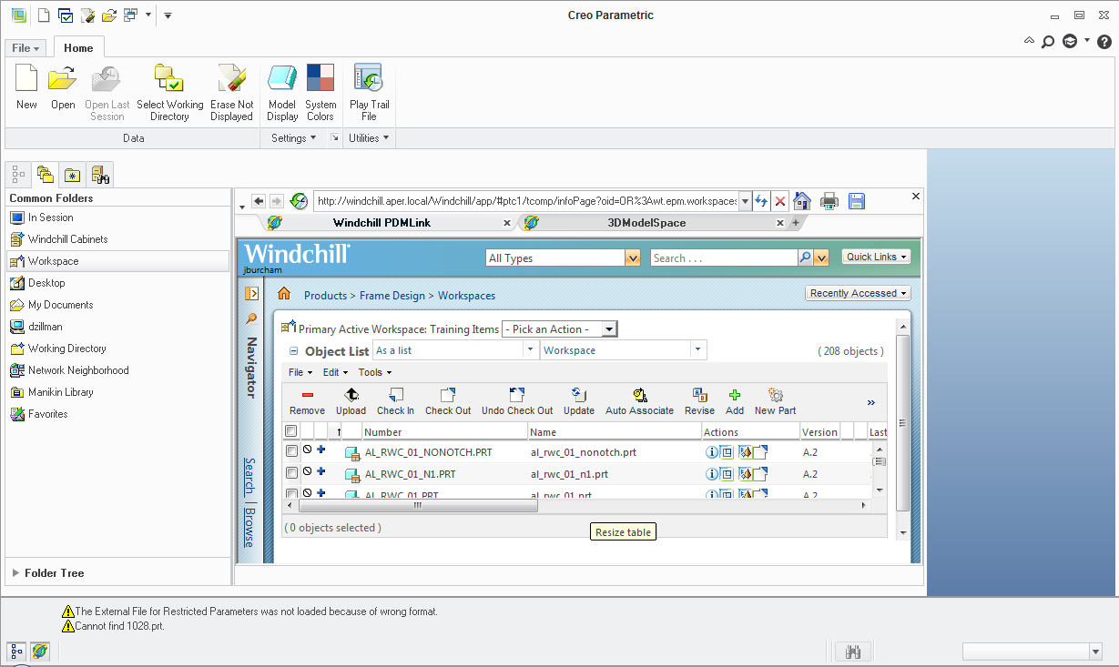

I just got new monitors and now everything in the Creo GUI is huge. I also can't really see anything in my Windchill. I've checked all the windows settings I am aware of for monitors, and those are how i want them.
Has anyone had this happen or does anyone have any recommendations on how to fix? I haven't been able to find any GUI options in Creo for this.huge+icons.png

I'm running the best resolution the monitors have to offer, I have the IT team working on it now. For some reason it only lets me use 1366x768, but with my old monitors I could run 1600x1200 so it looks like a monitor/graphics issue not a Creo issue.

The best resolution on a any LCD monitor is native. If the monitor only does 1366x768 (monitor limited) then that's a fairly small monitor(laptop). If the monitors native res is higher then your current limit, then it is the video card settings.
