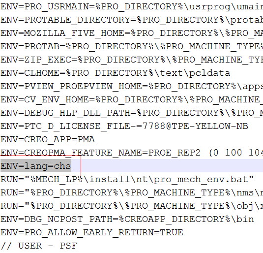

When I install Creo 3.0 m090 , I Add the chinese-simplified langurage package which is not working.
And I add the ENV=Lang=chs in the chs.psf which is still not working
When I select chs and open the creo, It's still English Interface.

Below the picture ( chs.psf  & install)

try ENV=PRO_LANG=chs
According to https://support.ptc.com/appserver/cs/view/solution.jsp?n=CS110907, you license must contain Chinese_translation license and this license must be included in ​psf​ file.

My croe 3.0 m090 is ok that is chinese-simplified interface.
