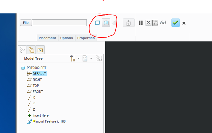

Dear all,
I have a 3D scan file and want to import it to CREO 3.0.
I do not have the reverse engineering license.
All I want is to import the xyz points from the file - as points.
I don't want to generate any surfaces or solids from the points. I only want the points.
Is this possible without the reverse engineering license?

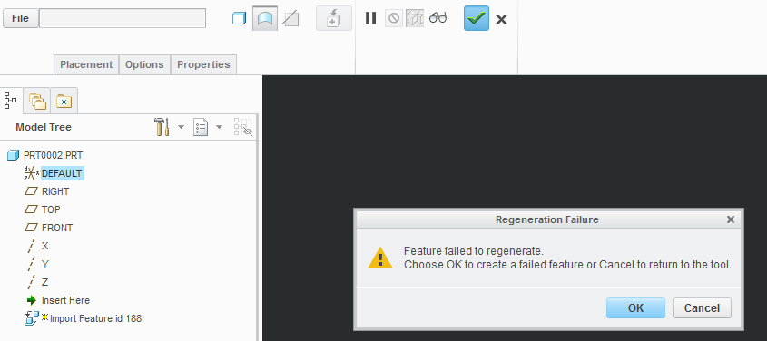

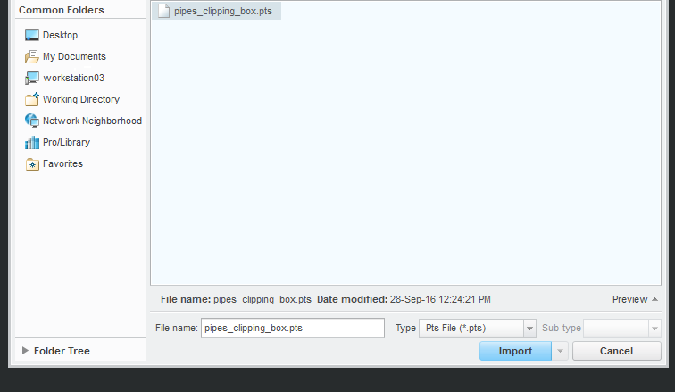

If not, why do I get as far as I get (shown in the images below)? Why does it allow be to select a .pts file if in fact I cannot import a .pts file?
I get as far as shown in the images below. It seems to always want to create a solid or surface body. But I want the raw points as datum points or as a single feature with all points inside it.
Any kind of help is appreciated.
i've tried automatic, geometry, facet and curve...

actually I found the solution mysself:
My .pts file (exported from Faro Scene) had the number of points in the first line followed by a line for each point with the xyz coordinates.
after deleting the first line - it all worked well.
The points and only the points are shown - just as I wanted them to.
mgrass1-VisitorAuthorAnswer
September 28, 2016
