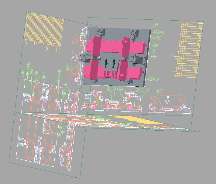

Sep 15, 2015 5:05 PM UTC
This is from Creo 2 M120, I didn't do anything for this to show. They can be hidden and are on the hidden Items layer.
Hope this helps
