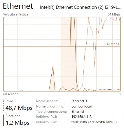

March 19, 2020
I have made the change but the quantity of data sent is augmented.
In attach you can see the data in the rotation phase
