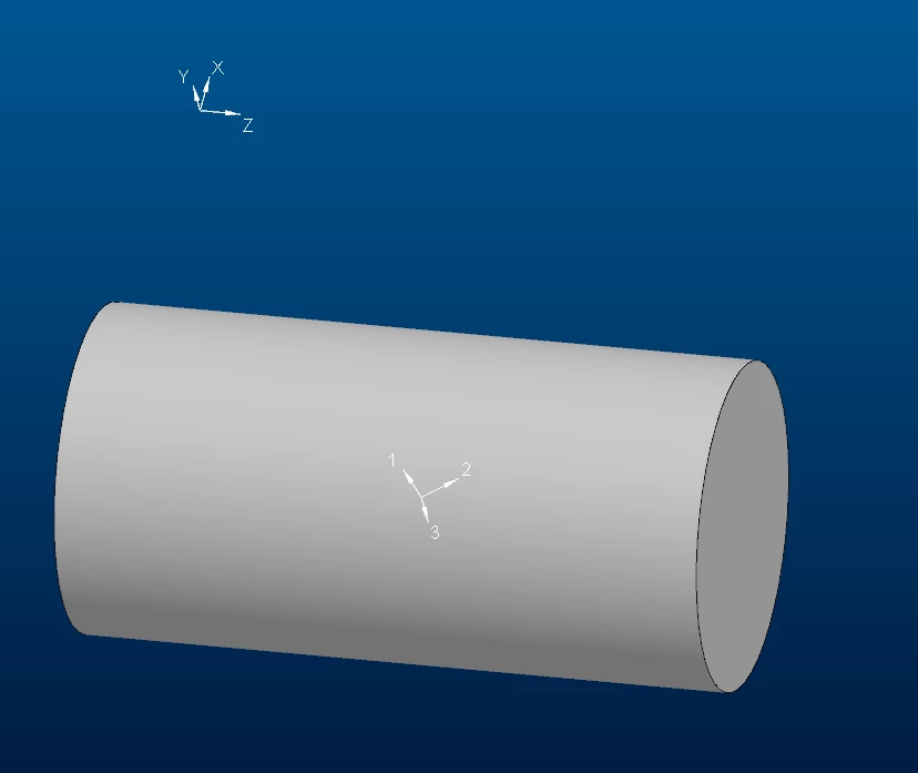

When I use Analysis / Mass properties / preview
The coordinate system displayed at center of gravity with respect to principal moment of inertia axis (1, 2, 3) seems not correct. For example, if I extrude a cylinder whose axis is not colinear to origin cordinate frame, the principal moment of inertia displayed is not colinear to the cylinder (when it should be)

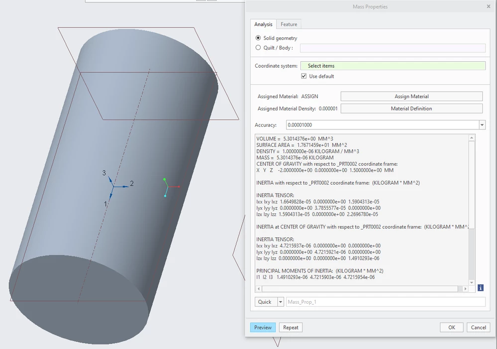

Thank's for your answer,
I made the same cylinder as you did. I have exactly the same mass analysis (different units 😉).
But the axis displayed seems to correspond to nothing, see attached picture. In my opinion, the axis I1 should be colinear to the axis of the cylinder (parallele to z axis).
What do I miss ?!
VOLUME = 5.3014376e+00 MM^3
SURFACE AREA = 1.7671459e+01 MM^2
DENSITY = 1.0000000e-06 KILOGRAM / MM^3
MASS = 5.3014376e-06 KILOGRAM
CENTER OF GRAVITY with respect to _PRT0001 coordinate frame:
X Y Z -2.0000000e+00 0.0000000e+00 1.5000000e+00 MM
INERTIA with respect to _PRT0001 coordinate frame: (KILOGRAM * MM^2)
INERTIA TENSOR:
Ixx Ixy Ixz 1.6649828e-05 0.0000000e+00 1.5904313e-05
Iyx Iyy Iyz 0.0000000e+00 3.7855577e-05 0.0000000e+00
Izx Izy Izz 1.5904313e-05 0.0000000e+00 2.2696780e-05
INERTIA at CENTER OF GRAVITY with respect to _PRT0001 coordinate frame: (KILOGRAM * MM^2)
INERTIA TENSOR:
Ixx Ixy Ixz 4.7215937e-06 0.0000000e+00 0.0000000e+00
Iyx Iyy Iyz 0.0000000e+00 4.7215921e-06 0.0000000e+00
Izx Izy Izz 0.0000000e+00 0.0000000e+00 1.4910293e-06
PRINCIPAL MOMENTS OF INERTIA: (KILOGRAM * MM^2)
I1 I2 I3 1.4910293e-06 4.7215903e-06 4.7215954e-06
ROTATION MATRIX from _PRT0001 orientation to PRINCIPAL AXES:
0.00000 1.00000 0.00000
0.00000 0.00000 1.00000
1.00000 0.00000 0.00000
ROTATION ANGLES from _PRT0001 orientation to PRINCIPAL AXES (degrees):
angles about x y z -90.000 0.000 -90.000
RADII OF GYRATION with respect to PRINCIPAL AXES:
R1 R2 R3 5.3033009e-01 9.4372905e-01 9.4372956e-01 MM

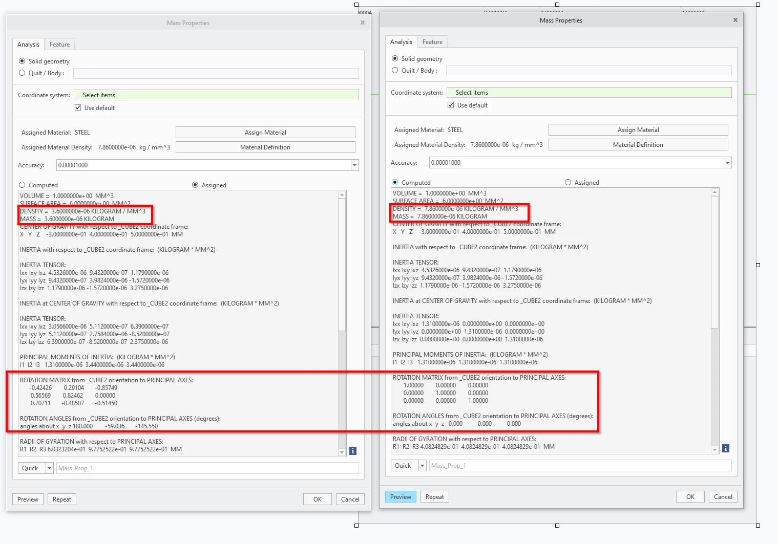

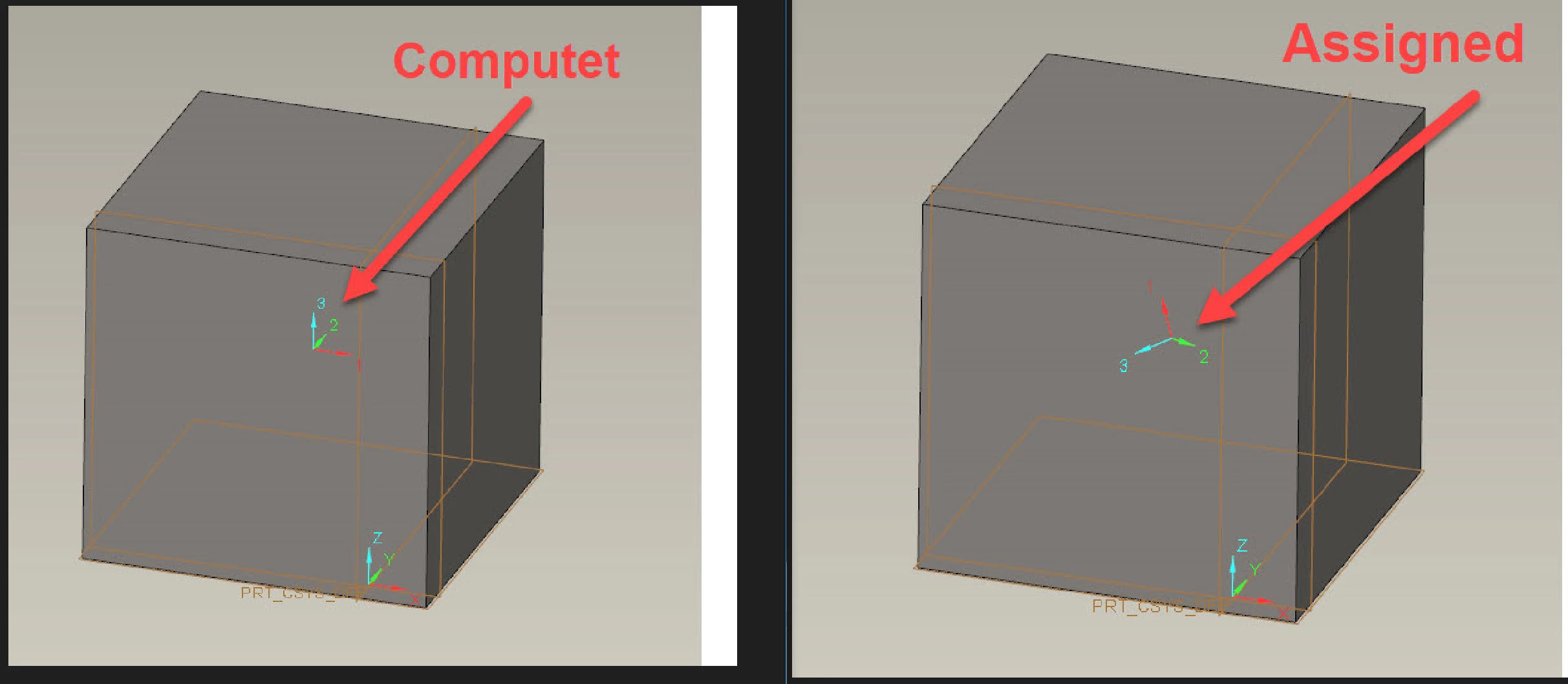

Hi @BB_10451093,
I tested the part in Creo 7.0.2.0 and 7.0.9.0, already tested by Martin in Creo 7.0.5.0, seems it was a bug in Creo 7.0.2.0 as it is reproducible for me  in Creo 7.0.2.0 but not in other datecodes.
Check the image from two of the datecodes
I hope this will help.
Thanks.

Hi all,
it seems that the bug continues in Creo 10.0.1.0 - . I see the roatation on the COG CS for the assigned parameter calculation.
Can someone confirm? Thanks
