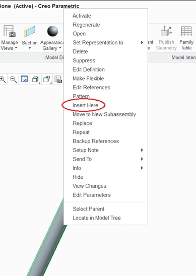

I am trying to record a mapkey in Creo for the Insert Here command, in an assembly:
I want it to be universal, obviously. I recorded it with the mouse, and it works in the assembly of the record, but doesn't in others.
Does anyone know the command line I might insert in the config.pro to make it usable everywhere and always?
The current lines of the recorded one are the following:
thanks
Tommaso

tleati12-AmethystAuthor
December 7, 2017
Hello Cadcam,
thanks very much for your reply and I am sorry I couldn't reply before.
I have tried your mapkeys but they don't work (I am using Creo 3 if it may matter).
In the lower left corner the message "Playing mapkey ih.." appears, and nothing happens. I have also tried to hit once more but with no success.
Anyway I found the solution, It was just to simply insert the line:
mapkey(continued) ~ Command `ProCmdActivateInsert`;
to enter insert mode
and eventually another mapkey with:
mapkey(continued) ~ Command `ProCmdResumeLast`;
to resume last set.
(no need to have a toggle function for the moment, even if it would probably be a finer solution).
I also have another question to ask you, how do you play double letters makeys by keystrokes (If it is possible)? when I try to hit for example "rl", since I have another mapkey named "r", it plays this latter instead of the "rl" one...as if it took just the first letter.
bye
StephenW
December 7, 2017
You can use double letter mapkeys as long as the first letter is not a mapkey by itself.
So if you have a mapkey that is "L", you can't have any other mapkeys that start with "L".
The key is, don't use single letter mapkeys.
