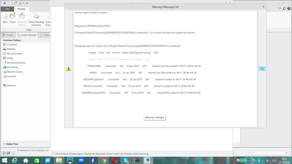

I have problem with installation when I want to start up Parametric (students version) only error window pops up.
Do you know what to do ?

License which you are using is to work with Creo 3.0, however you are trying to start Creo 4.0.
You need a new license for Creo 4.0.
