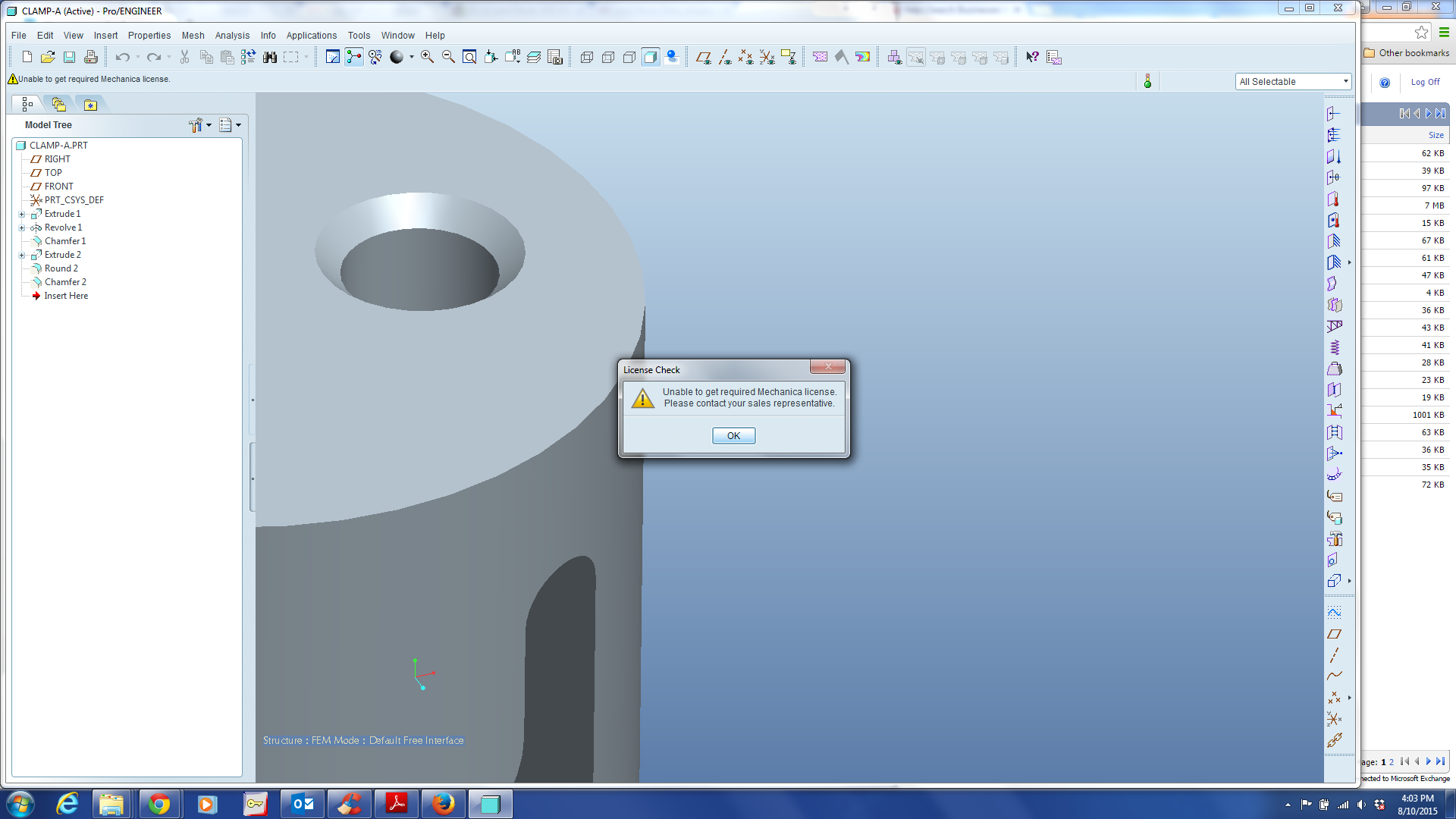

Installing Creo 2 on a computer running Wildfire 5
I have an updated license file that lists both creo 2 and wilfire 5 but for some reason when I launch creo 2 is says license file not valid. Wildfire 5 works fine with the new license file. How do I make sure the creo points to the correct license file? This is a node locked license for a single laptop so maybe there is an easier way to install them both. Any input would be helpful. We are not on maintenance so trying to figure this out without ptc. Thank you in advance

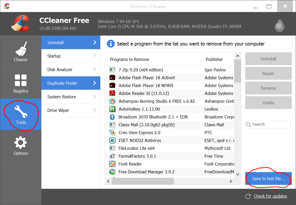

Jul 24, 2015 5:26 AM UTC
Lawrence,
I think Mahesh is right. If you need our assistance with finding license managers, please upload the list of programs installed on your PC.
To get such list, download CCleaner - Portable and use Save to text file ... button.
Martin Hanak

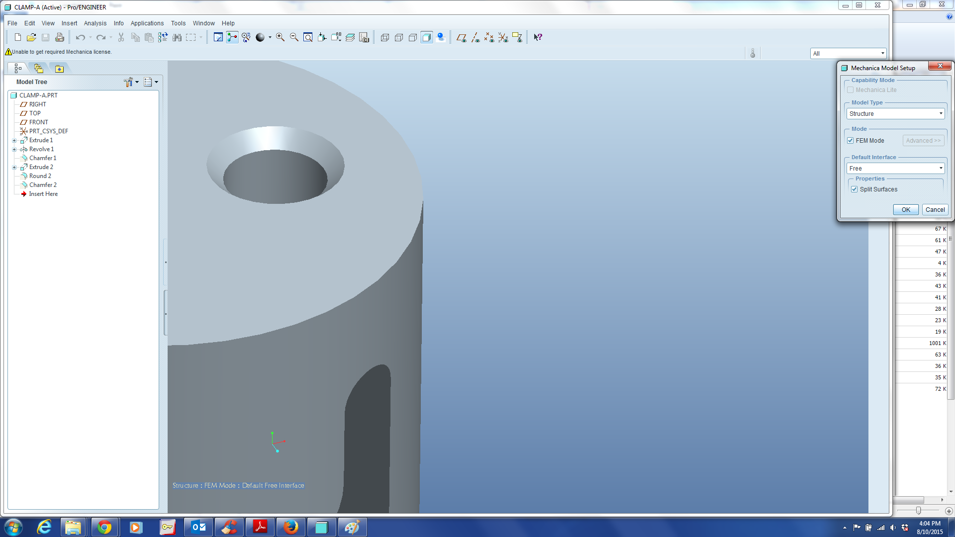

Going to try this and see if it works. I also noticed that Mechanica Lite is greyed out under Capability Mode section for some reason. Any idea on why that would be?
Mahesh_Sharma
22-Sapphire I
Aug 10, 2015 7:59 PM UTC
Add a snapshot for Mechanica Lite?
MIADESIGN1-VisitorAuthor
Aug 10, 2015 8:10 PM UTC
