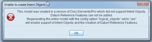

I was going to investigate using some intent edges today, something that
we have never really done in the past.
We are on Creo/Elements (WF5) M070.
Whenever I try to add a reference feature, I get this error:
I have added this to our base config. I have manually regenerated this
model. I have even gone into model player, checked regeneration, and
regenerated every feature one by one, and I still get the same message.
What am I missing???
