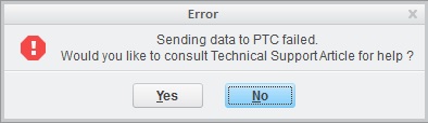

I have been trying to set this up. I think I got it working. However, the first several times I tried to manually send the data it said it failed. It asked if I wanted to view the help files. I selected Yes and it took me to PTC's site but couldn't find the document.
Error: Document 199194 is not customer viewable as it is an internal PTC document.
Why does it ask if I want to view it when I can't see it?

I have published that article now, it should be available to view. Previously, we discovered an issue where data could not be sent when customers were using a proxy server that required authentication. We have a solution that will be made available in an upcoming datecode.

However, I am having problems with the other computer. There was info from Monday that was never sent. So I uninstalled Creo and the advisor. Deleted the directories and rebooted. Then I re installed. I started Creo and tried to manually send the info but it failed again. Something is preventing the computer from sending the information. Every time I try it I get this error.PTC_PA_Error.jpg

We did a desktop sharing and he checked a few things.  He manually sent the data and we got that error above again.
He looked around a little more then tried sending the data again and this time it went through.

I think we figured it out...at least what is causing it.
In my startup batch file that everyone uses I had the line:
start "" "<creo_install>\Parametric\bin\parametric.exe" "<creo_install>\Parametric\bin\parametric.psf" %*
It doesn't need that whole thing.  I removed the .psf reference and it seems to have worked.  Now it's just this:
But it is still odd that if I manually install Creo it works fine but when I use the silent install it doesn't.
