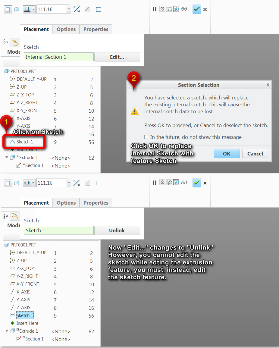

Yup - that is a good point.  You can have the sketch outside the feature if you think ahead.  However once you created the feature with only the internal sketch it is not extractable.  However, you can use my work-around to create a sketch feature, move it before the extrusion feature and then use that within the extrusion feature to replace the internal sketch.

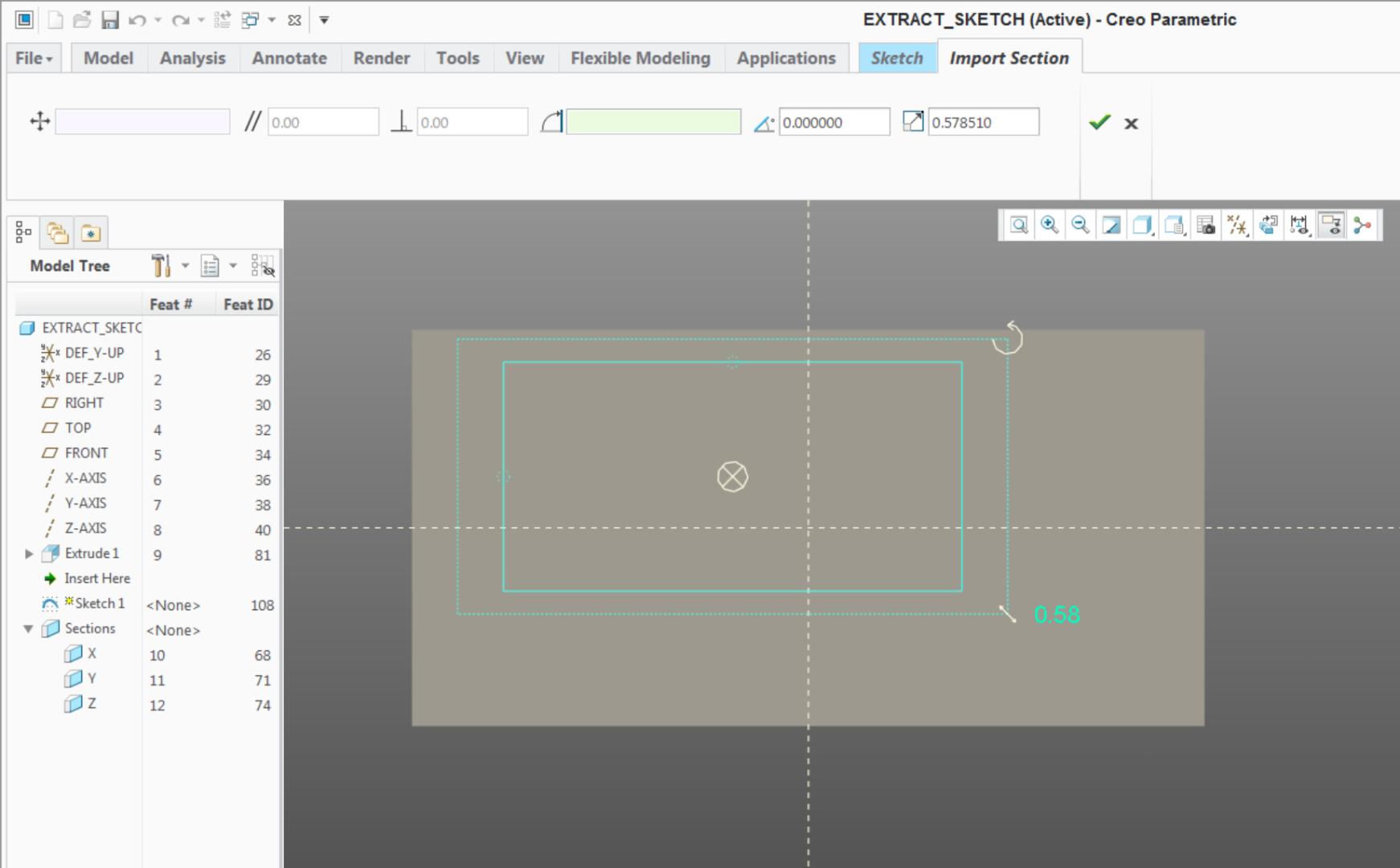

Best solution is to edit the sketch first.  Then File->Save As...  name the sketch.  Then set up a new sketch.  If you are inserted at the extrusion, you should be able to "use previous" for the sketch plane.

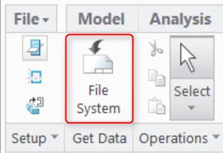

then click "file system" and open your saved sketch.
The sketch will come in probably wrong scale.  you can place it anywhere, and then change the offsets to 0, and the scale to 1, then click ok and you should have minimal dimensioning to do.  It really helps if your sketch is already dimensioned mostly within itself and minimal dimensions are referencing items outside the sketch.  like - 2 dimensions.
as it comes in:

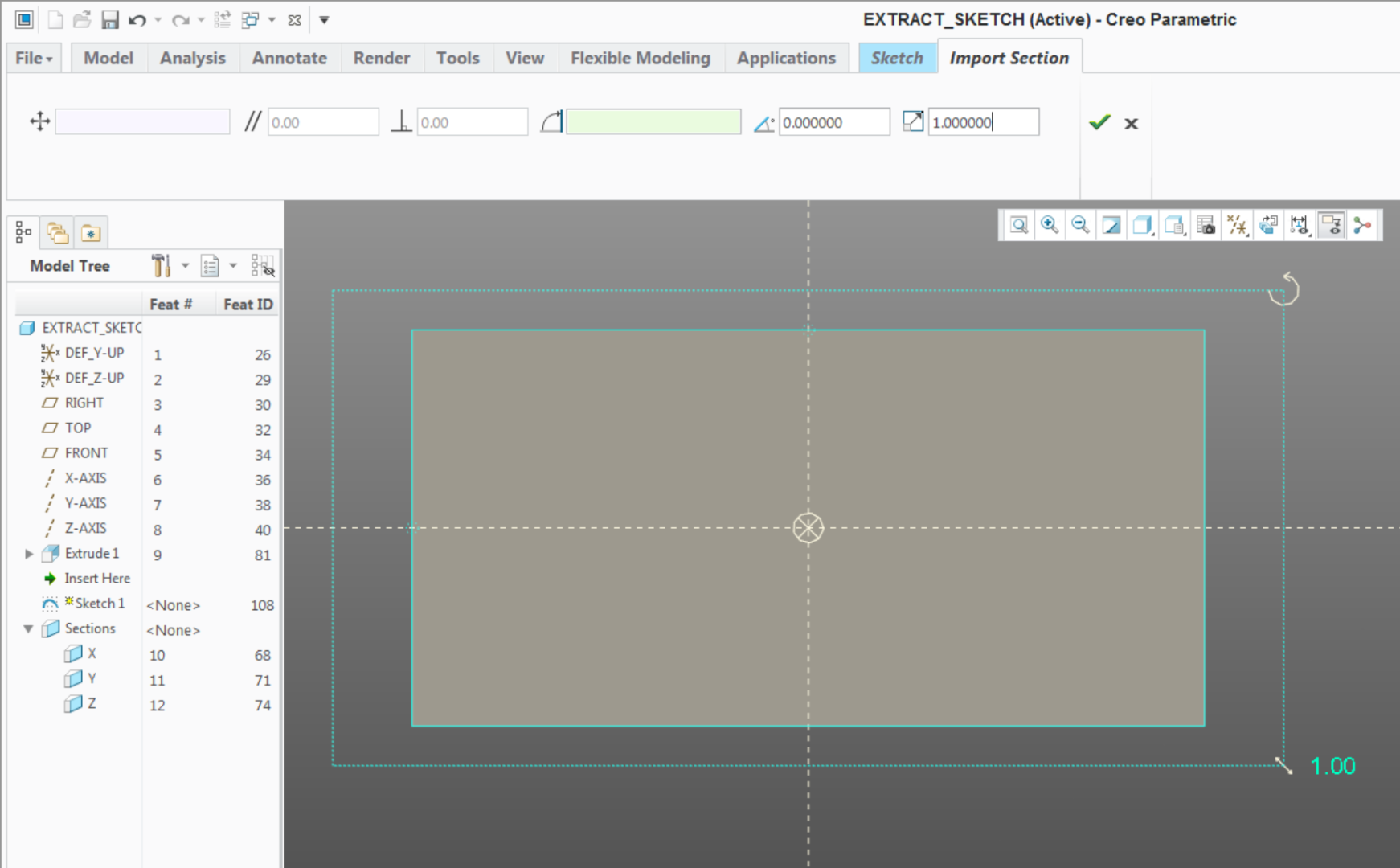

Then after placing it and setting "||" and "T" to 0, and "[/]" to 1.  that's horizontal pos, vertical pos, and scale.
After this, delete your extrusion, and your new sketch should match the old one.  It's a work around but it's the best way I'm aware of.  (we've been asking for ages to be able to extract the sketch! would be great, but as of yet it is still not possible - as far as I'm aware)
