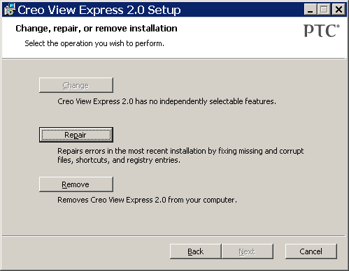

    I've checked my above post and have a final answer.
    Yes,
    You can easily do this. When I went to Install on my flash drive I was shown a Repair Install screen as it was already on my PC.

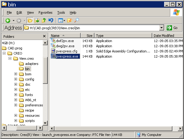

    Instead of Uninstalling like an untrained Tech Support person does when they don't know what's wrong, I just located the Install Directory in Program Files and Copied it to my flash drive and it runs without problems when launched off the Flash Drive
    Aborted Install and just copied the Entire Install Directory tree to my flash drive.
    Navigated to the bin directory and launched the Application Executable pvexpress.exe
    Since there is no license file requirement for Creo View Express you do not need access to the registry except for the Open With Shell data used to tie it to file types it can open.
    The date modified shows my custom setting for "YY- mm.dd" because I know it's the 21st century
    Michael
    P.S. If you try it on a machine w/o ProdViewExpress already installed you may be able to browse to your USB to choose it as an install folder. If not you can just copy the entire install directory to your flash drive as I did in this step as shown in image 2.
