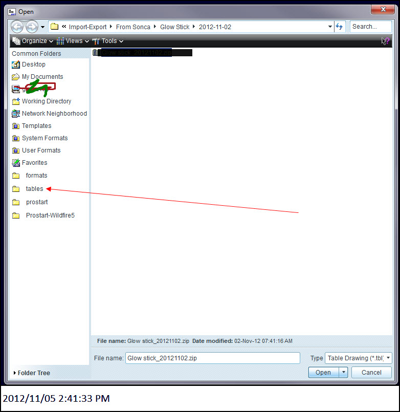

Nov 5, 2012 7:41 PM UTC
pro_table_dir <YOUR PATH>
Oops. I just realized this is only in Creo 2.0 (Maybe in 1.0 as well but we don't have that installed.) This option is not in Elements/5.0.
What we've done before is, we had our Table folder on our server and the location saved to the "Common Folders" column, so it's only one mouse click to get to the folder where the tables are located. See the pic attached.

Nov 5, 2012 9:16 PM UTC
Reinhard & Grahame,
Thank you for your replies.
The pro_table_dir config option in Creo 2 is exactly what I was looking for in Elements/ 5.0. Thanks for verifying it dosen't exist.
We should be using Creo 2 by years. We're currently deploying a hardware / Windows 7 upgrade to support going to Creo 2.
Thanks again.
