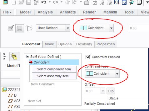

Just wondering if there is a config option to set assembly default constraint type?  For example, I want the default to be Coincident, can this be done?  Right now, the default is Automatic.

Yes Sir!
auto_const_always_use_offset
Yes - auto constraint always creates offsets.
No - Auto constraint snaps align or mate if surfaces are within tolerance. (Default behavior)
Never - Auto constraint never creates offsets.
If you choose to use the default behavior of working within a tolerance (epsilon) you can specify the epsilon to give you more or less room to make it behave according to your preferences.
comp_normal_offset_eps
comp_angle_offset_eps
auto_constr_offset_tolerance
Try checking this PPt for more info : https://www.ptcusercommunity.com/servlet/JiveServlet/download/230493-60792/PTC%20User%20Group%20-%202013-10-03%20-%20Aut…
