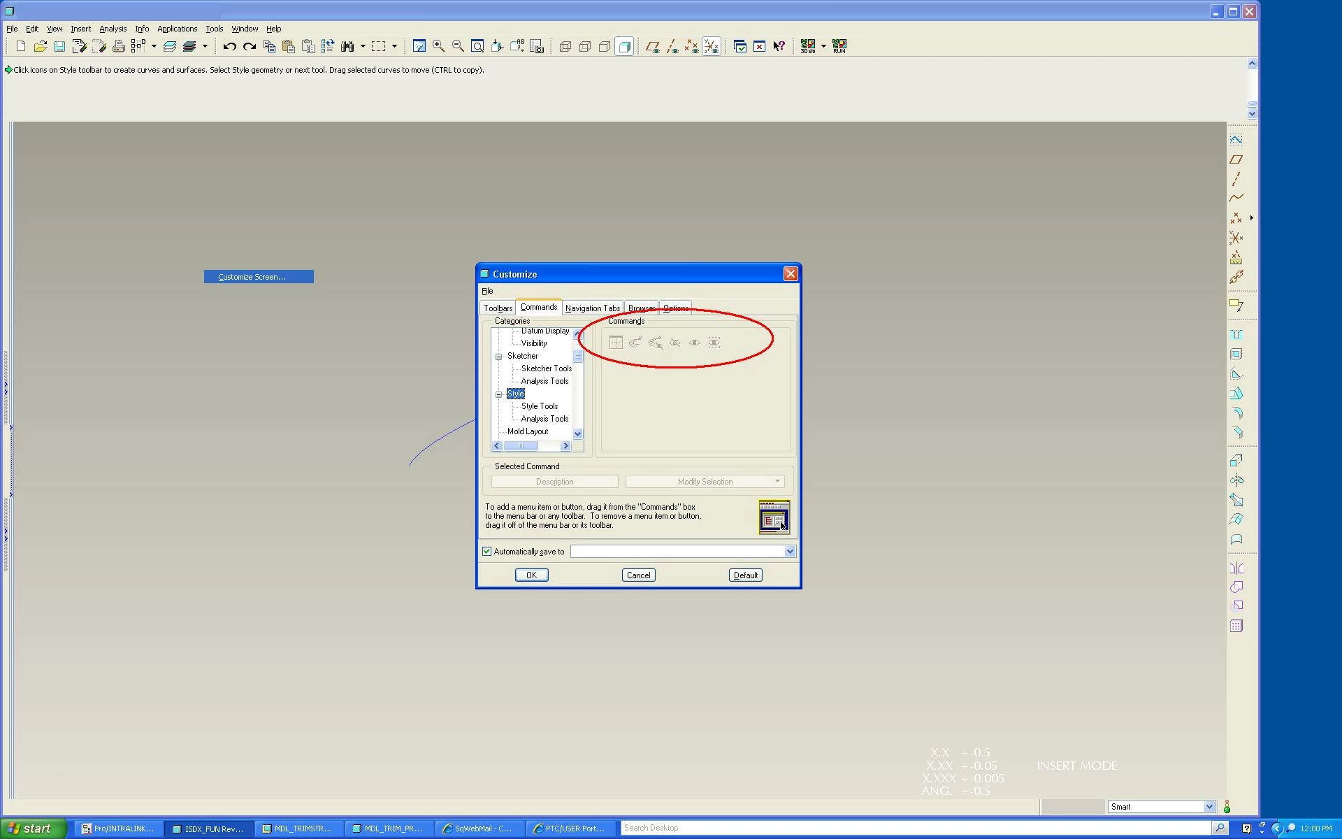

I want to display the curvature map ofmy style feature curves but the stinkin option is grayed out in the Customize Screen menu!I can get the Analysis curvature to work...but that does not help. Analysis features are not real time. Is there a config option I need to switch. The client is running WF2.

I am in the style feature and module. The curvature display and the curvature hide are the only two things grayed out in Customize Screen.

Hmm, I just fired up WF2 and discovered the same thing - I cannot add
these two curve plot icons either. The rest of the icons are not
disabled, if I'm in a style/ISDX feature.
I was thinking that I didn't see any of the other Style/ISDX toolbars in
your screen shot, thinking that perhaps you need them to be on. I had
them on and it didn't matter for my test though.
There was once a quirk with modifying the sketcher toolbars and commands
where you had to be in sketcher and you had to be in the initial Pro|E
window, I thought this was perhaps the case with Style/ISDX too. I had
only one window open and it didn't work for me either.
I'm stumped.

Yep...I am as well. I can't understand using a styling / surfaceapplication without the ability to see the curvature map in real time.
does anyone know if this was a bug in WF2? It makes zero sense!
