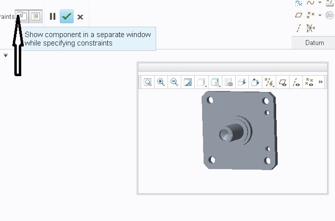

We had experienced the same problem
If we keep option "show component in a separate window while specifying constraints" checked on, assembly file zooms out to zoom all as you specified.
if we check this option off, part to be assembled will be nowhere in view. We now prefer to keep this option off & after selecting the part, we check it on to see the part in separate window & assemble. Also we have to check it off before hitting return after all the constraints are defined.
This adds two extra mouse clicks for every parts assembled, but much quicker than re-positioning & zooming assemblies all the time

in CR3 M090 I can't see any zooming during assembling new component (see video). Unfortunatelly (as Pushkar mentioned) initial component position is near default assembly coordinate system and therefore new component is not visible. User has to:
>>> select component reference in Model Tree
-OR-
>>> activate "Show component in separate window" button and select component reference in separate window
-OR-
>>> zoom out main graphics window and select component reference in it
