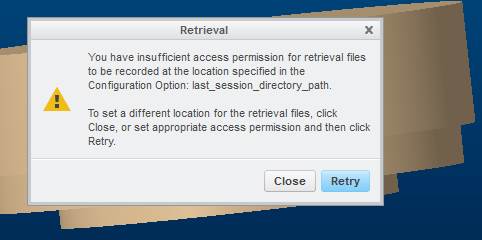

We are facing below issue when working in Creo. Every time save or regenerate,below window hurdle us. Please check and advise.

look for following options inside your config.pro files and check their values
LAST_SESSION_DIRECTORY_PATH
LAST_SESSION_RETRIEVAL
To forbid saving session information, set
LAST_SESSION_RETRIEVAL  no

StephenW
December 14, 2016
You likely have set the last_session_directory_path to a directory that you do not have write access permission. If you wish to use this option, you will need to specify a valid directory that has appropriate read/write access for the user.
