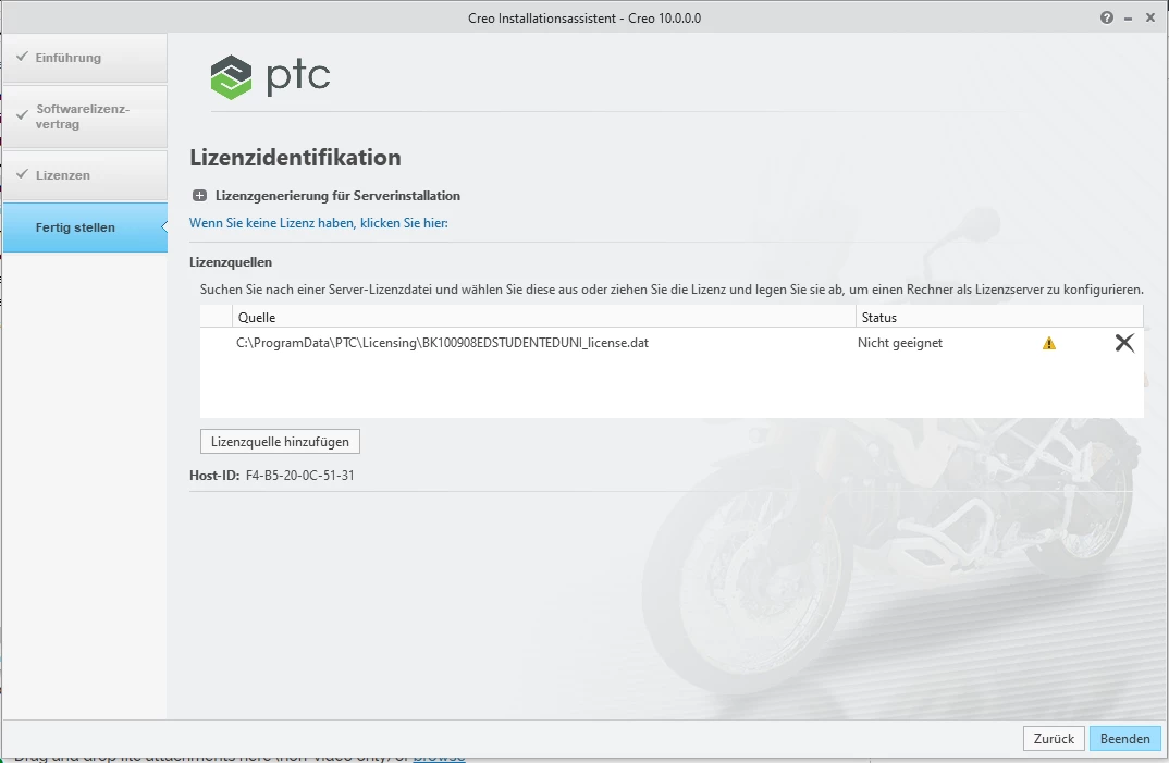

I am reaching out for assistance with an issue I’m experiencing while trying to activate a license using your License Indicator. I received an order number from my university and have been trying to generate a valid license based on that.
While I am able to request the license and it does appear in my files, the status is always shown as “Not Eligible.” I have already attempted several steps to resolve the issue, including:
  • Deleting and reinstalling the license files
  • Creating a new PTC account with a different email address
  • Reinstalling the software entirely
Unfortunately, none of these steps have resolved the issue, and the license remains unusable.
I would appreciate your support in resolving this. If you require any additional information, such as the order number or screenshots, I will be happy to provide them.

1.]
BK100908EDSTUDENTEDUNI code enables you to install and run Creo Parametric up to 10.0 version.
2.]
BK100908EDSTUDENTEDUNI_license.dat contains locked license, because of that you must not install license manager as described in CS343103.
3.]
The described problem may be caused by the license file being generated for an incorrect network card MAC address.
To confirm this, I need to see the contents of your license file as well as the output of the ipconfig /all command.
Open Command prompt window, run ipconfig /all > ip.txt command and upload ip.txt file.
