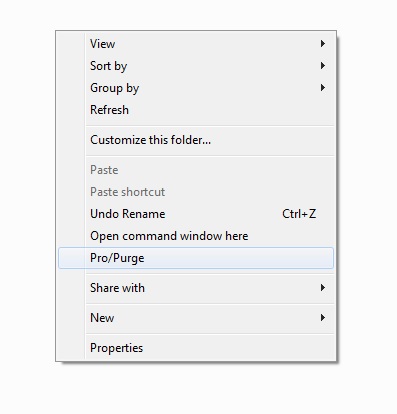

A million years ago, me and some people in the Pro/E newsgroup came up with a batch file that deletes files you don't want, and then calls the Pro/E purge.bat and does a normal purge. and then I have that setup in the right-click context menu so when going through directories in Windows Explorer I can purge quick and easy.

This is the code in the batch file, just cut/paste this into Notepad and edit it for your information and then save it, then rename it with a .bat file extension.
The lines with "echo del", the del is DELETE , and it's a hard delete, everything with those extensions is gone when you run the batch file, so edit that area, take out things you want to keep or add other file extensions if you have other things you want to delete.
Adding items to the context menu is adding some lines in your registry and some people are not comfortable with that, so I am not going to describe that here, also because there are countless guides on how to do it already. So you can Google "add item to context menu background" and there are guides for that, the key part of the registry entry is the "background" entry if you want to be able to right click any where in the current window and purge it.
And/or you can check out Olaf's tool, I am pretty sure his installer writes to the registry for you. But you don't have the delete options, it all depends on what/how you want to purge.
