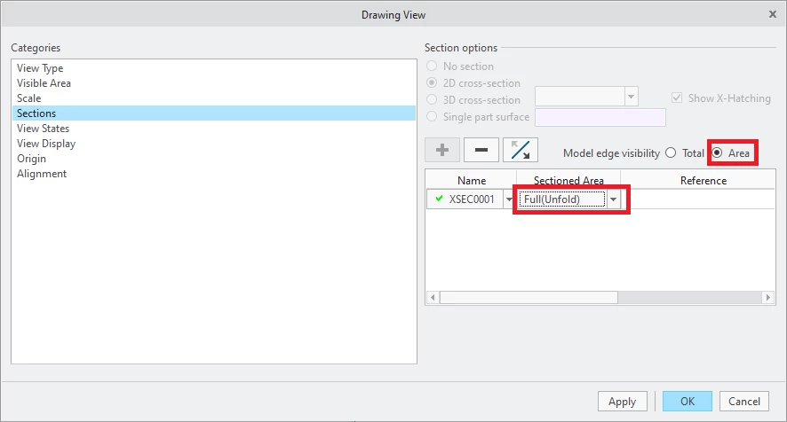

I am using Creo Parametric Release 6.0 and Datecode6.0.6.0
Problem with solid center line showing up in a drawing view. Its a offset section with a sketch where there is two lines in 90 degree The section is showed by a full unfold, partial view.
Not sure if this is suppose to look like this or if its a bug or if there is any detail settings to hide the solid line that goes through the hole feature?

Hi, here is 2 different drawing views with same issue. There is a solid line that i would like to have removed.
March 17, 2023
there is drawing option create_area_unfold_segmented. It is set to yes by default and you can switch it to no.
Unfortunately it only affects Area section views, not Total section views.
Fortunately there is also drawing option show_total_unfold_seam. It is set to yes by default and you can switch it to no.
It affects Total section views.
