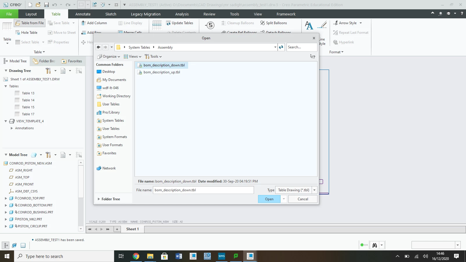

We have recently rolled out Creo 7.0 but have found an issue where students cannot seem to access the bom_description_down.tbl file so they dont get to create a bill of materials.
(Please excuse my ignorance of terminology, im just the school network manager, i dont know much on how to use CAD).
Thinking it might be a permission issue i tried every combination of secuirty settings i could think of and even made a test student local admin of the machine but still he could not access this file.
Is this something anyone has ever seen before?  Screenshot shows the teachers account who can see the file.

Does the teacher PC have a config.pro with pro_table_dir set to something different than the student PCs?
The screenshot is using the system directory location for the table (tbl) files. The pro_table_dir configuration option sets that default location.
Have you tried having one of the students browsing to the folder starting from the root drive folder?

You might be missing config option pro_table_dir. Try setting config to folder holding table files.
Jan 15, 2021 10:06 AM UTC
Thanks so much for the info.  I will have a look into this.  Our student machines are deployed by MDT and our teacher machines were installed manually so perhaps there is a discrepancy there.  I will take a look and report back
