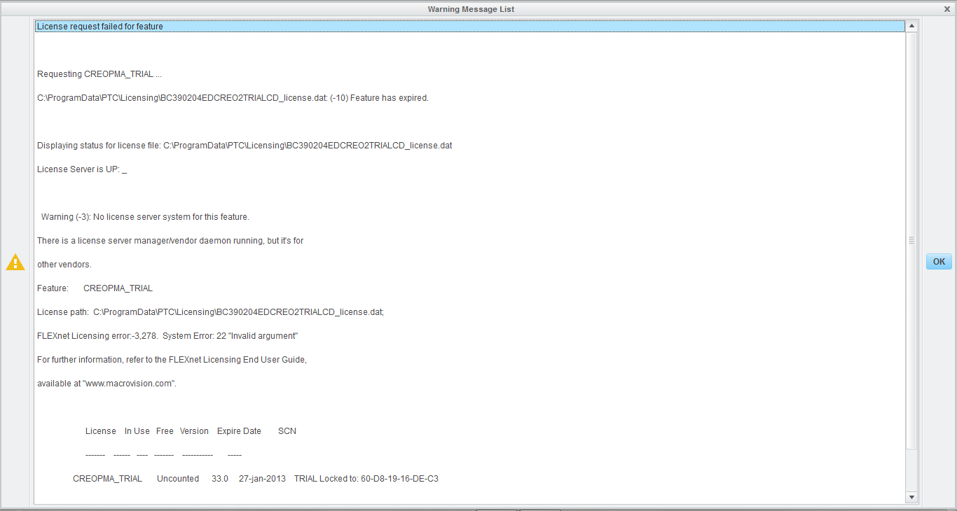

However, upon opening Creo Parametric 2.0, I get the following message:
Creo error.png[Click to enlarge]
I assume this is an issue with the license file (if it is there at all).
This also happens when opening Simulate 2.0

So found in C:\Program Data\PTC\Licensing that I have a license file left over from my trial version, as well as the student license. I sent the trial license to the recycle bin, but it still didn't work. Any other ideas?

in CR2\Creo 2.0\Parametric\bin directory you can find parametric.psf file, open it in Notepad.
Locate ENV=PTC_D_LICENSE_FILE-= line. Behind equal sign you have to enter the path to your license file.
Locate ENV=CREOPMA_FEATURE_NAME= line. Behind equal sign you have to enter the name of Creo Parametric license. You can find the name in license file behind INCREMENT keyword. It begins with PROE text string.

Since filing an academic support request (and uninstalling), I was sent a new license file by PTC. Unfortunately, the Installation Assistant now crashes while 'attempting to retrive availible application information'. I have no way of telling whether or not the new license has worked, though.

Do not use WEB installer, download 4GB full package and install from it.
