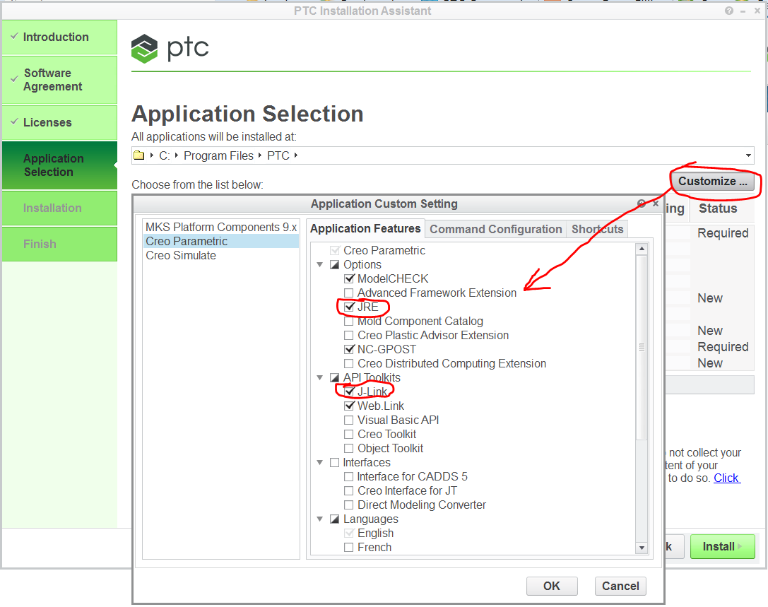

February 13, 2017
during installation I selected two highlighted items.
Then I installed j2sdk1.4.1_07.
My compilation batch file contains these lines:
set CLASSPATH=E:\PTC\Creo2_M190_JLink\Creo 2.0\Common Files\M190\text\java\pfc.jar;%CLASSPATH%
E:\PTC\j2sdk1.4.1_07\bin\javac.exe *.java
MH

February 13, 2017
as I wrote in previous reply, you have download and install j2sdk1.4.1_07. This version is supported in CR2.
I think you do not have to use jlink_java_command config option, if JRE item is installed with Creo.
protk.dat that I used for install_test j-link application is attached.
