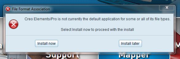

Hello all, i just installed Creo 3 out of curiousity. I have no immediate plans to start working with it, justed wanted a look. I currently work with Creo 2 & Creo Elements/Pro 5. I configured my Creo 3 install, start up directory, config files etc. all looks ok so far. I was a little nervous my other 2 versions would screw up, but thankfully they fire up fine, apart from one thing with the older Creo Elements/Pro. I get the following message alert (see image). I have just been clicking 'Install later' & things seem to work fine from there on in, but i don't want to see this message every time i launch the software. What would happen if i clicked 'install now'? It is vitally important that i can continue to work with this version, because many my customers still use this. Any advise would be greatly appreciated.

This is due to product view and to correct this, browse to <Install location Wildfire 5.0>\install\addon and execute ProductView_Express_32_64.msi and repair the installation.

Thanks Mahesh, that was obviously the root of the problem, i did as you instructed, & it launches cleanly now.
