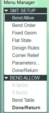

Hello Everyone. Here's a question about the K Factor in a component.
When I open a part, I go to the EDIT menu and select SETUP, from there I'm able to select the bend allowance and select my K/Y factor
but they show grayed out...

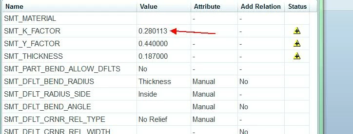

If I select PARAMETERS instead
I can see what the current value is. I get a message that the value has been edited from the default.

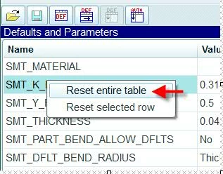

I can reset the whole table by right clicking
But still, I'm not able to change the values.

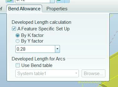

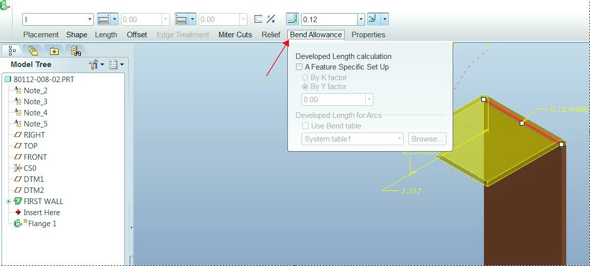

Now, if I select a flange and EDIT DEFINITION, I can control the bend allowance independently...
Am I doing something wrong? Do you think these options are grayed out because the part was modeled in certain way or because my config is set up to gray it?
If I change it in every feature, would it have the same effect?
