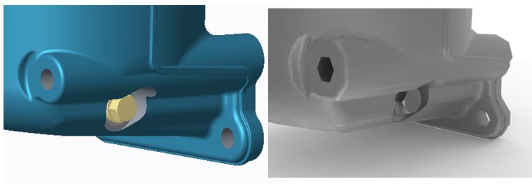

I am currently having some unexplained problems with the PTC Creo 3 models that I am trying to render in Keyshot.
As you can see the mounting holes look fine in Creo but like hexagons in Keyshot.
Before exporting the models into the .bip file I changed the settings within Creo so that the edges display quality was set to high quality and the shade quality was set to 21 out of a possible 50.

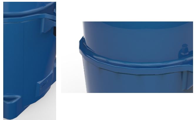

In a separate model with self shadows selected I got the rib like shadows under the cover as shown on the right. Also on the base there was an unexplained vertical line that I could not get rid of without blowing out my model with lights; self shadows has no effect on this line.
I've been using some Keyshot tutorials to help me render some of my previous work but these anomalies are making it very tough to get a great image without having to pull it out into Photoshop which I really want to avoid for efficiency reasons.

Not entirely sure - supposedly Keyshot can use NURBS surfaces directly from Creo, but the problem you have looks like a tessellation problem, so I'd check the config settings associated with exporting to Keyshot for that. There are some amusing examples on the web of output similar to yours that were fixed by changing tessellation.

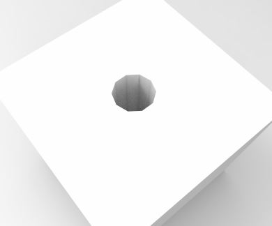

Hi there Martin thank you for your time,
Creo M030
Keyshot 5.3 pro
Keyshot plugin 3.10
This is a simple 250x250x250mm block with a 81mm diameter hole in it...about as simple as you can get but the edges are still not right.
Before exporting the models into the .bip file I changed the settings within Creo so that the edges display quality was set to high quality and the shade quality was set to 21 out of a possible 50 (I have no tried at 50 - there is no difference that I can see)

nfoulkes1-VisitorAuthorAnswer
Dec 6, 2015 6:21 PM UTC
Problem solved by increasing the tessellation value in the settings of the plugin.... thanks all
