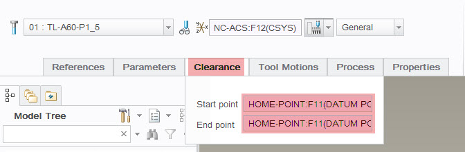

I think you need to create a point for "Start" and "End" points reference which columns in Clearance of each sequence. Please follow below procedure.

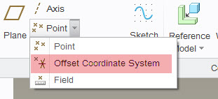

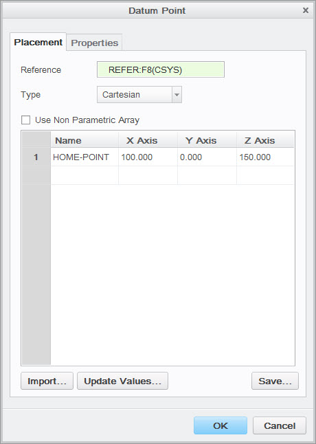

1, Please select point datum “Offset Coordinate System” to create a point (X100, Y0, Z150)
2, “Start point” and “End point” are refer that point in the sequence.

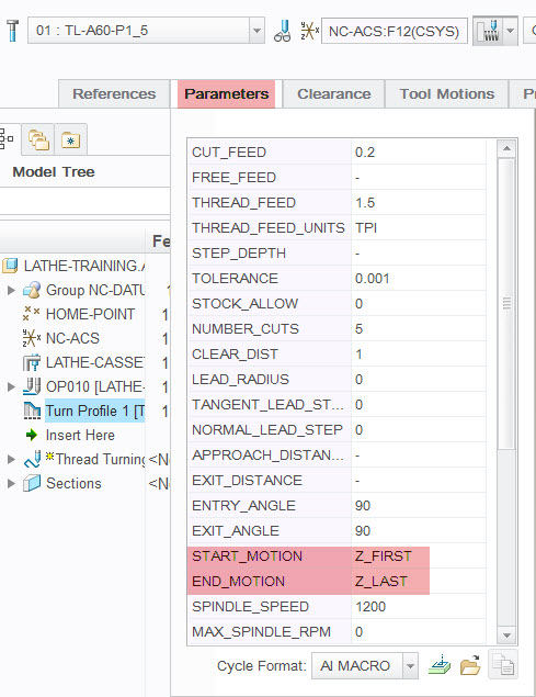

3, Please define “START_MOTION” and “END_MOTION” parameters in your sequence. My opinion is internal tool with “START_MOTION”= Z_LAST and “END_MOTION”= Z_FIRST, external tool with “START_MOTION”= Z_FIRST and “END_MOTION”= Z_LAST.
